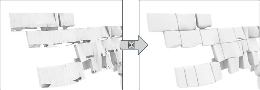

Development Depletion fix was initially developed to handle the Deswik stope depletion method applied during the scheduling process. However the tool is very effective for fixing any invalid solid wireframes and deriving reasonable stope shapes for modelling.
When using the tool, you are prompted for a ‘final offset’ this allows you to define the offset of the final stope from the original - the tool will result in in some smoothing of the original shape, using a small offset (0.25-0.5) ensures that the final result matches the corners of the original shape.
You can select any number of stope object to run this as a batch so on a full set of stopes for a LoM model for example.
Custom options - right clicking provides additional options for the tool
To repair the volumes, stope shapes are inflated and deflated, when using the custom options you can define the size of the initial inflation, you can additionally define the size of the wrapping mesh and the optimisation of the mesh to automatically reduce size of the output.
Larger initial offset values will handle larger holes/errors in the initial volume, but will result in more simplification of the geometry.
