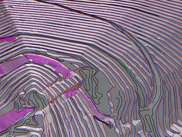

- Go to Package Manager, install ‘Terrain Mesh’
- Select the curves from the survey that you want to mesh, type terrain mesh, use a fine tolerance (1 m?)
- Reduce the mesh using the _ReduceMesh function (perhaps 95%), this might take a while
You will then have a mesh that follows breaklines!
